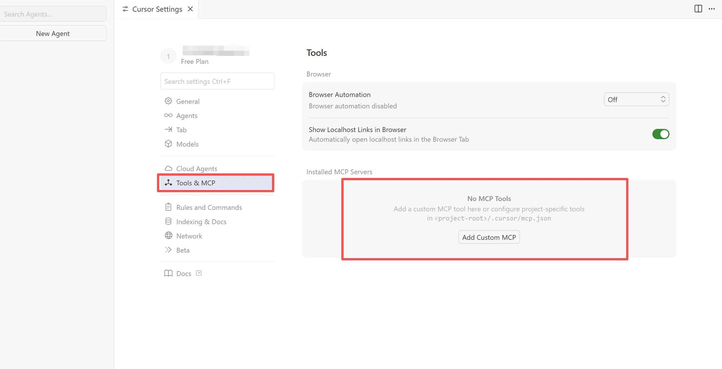

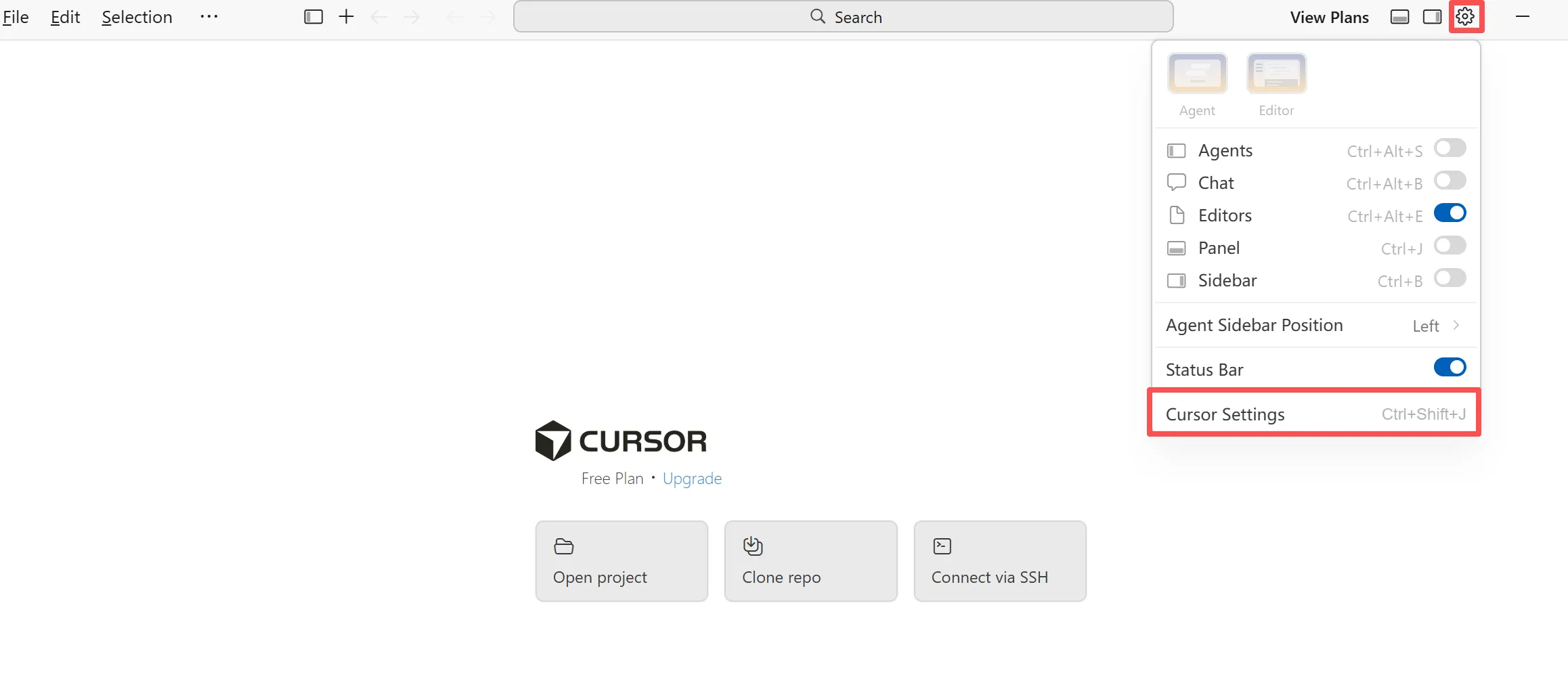

Step 3: Configure Your AI Client (Example: Cursor)
  • Get Cursor: Download Cursor and sign up/log in to your account
  • Access Settings: Open Cursor and go to Settings → Tools & MCP → Add Custom MCP

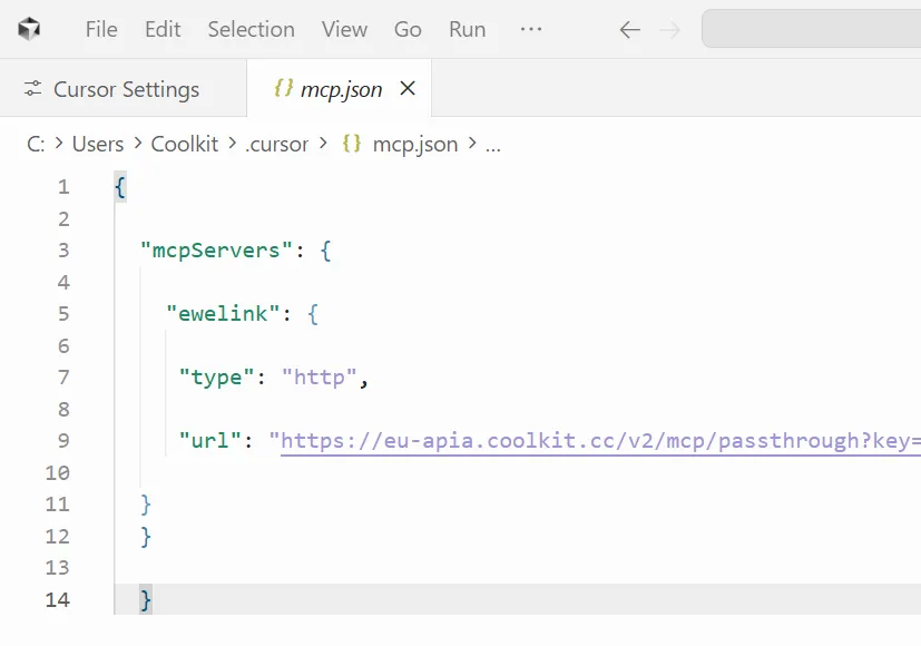

  • Add Server: Create a new entry with this JSON format:
"mcpServers": {
  "ewelink": {
   "type": "http",
   "url": "PASTE_YOUR_eWeLink_MCP_SERVER_URL_HERE"
  • Save & Restart: Save your configuration and open a new chat/agent session
